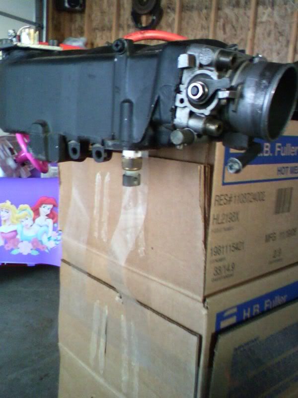

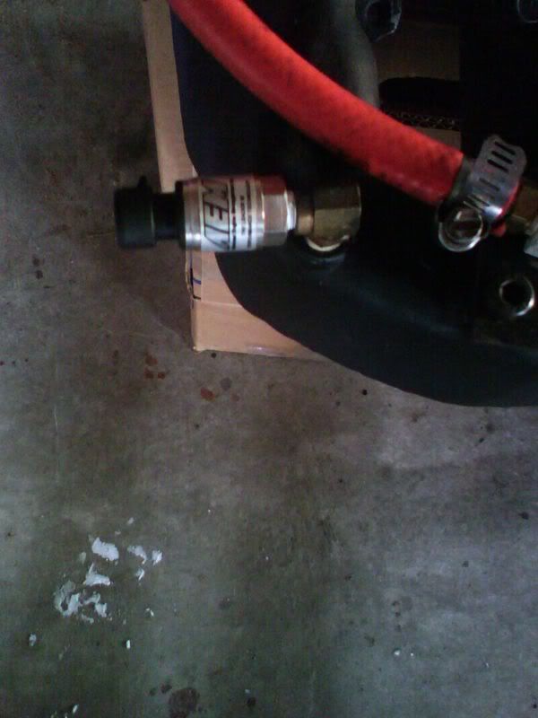

On a different topic, i found some niffty places for the MAP and AIT senors.
Apperently the GM AIT sensor will fit perfect into the EGR port once tapped, quick cell pic:
And with a couple of fittings the blocked JDM vacuum port near the battery is a good place for the MAP sensor:
